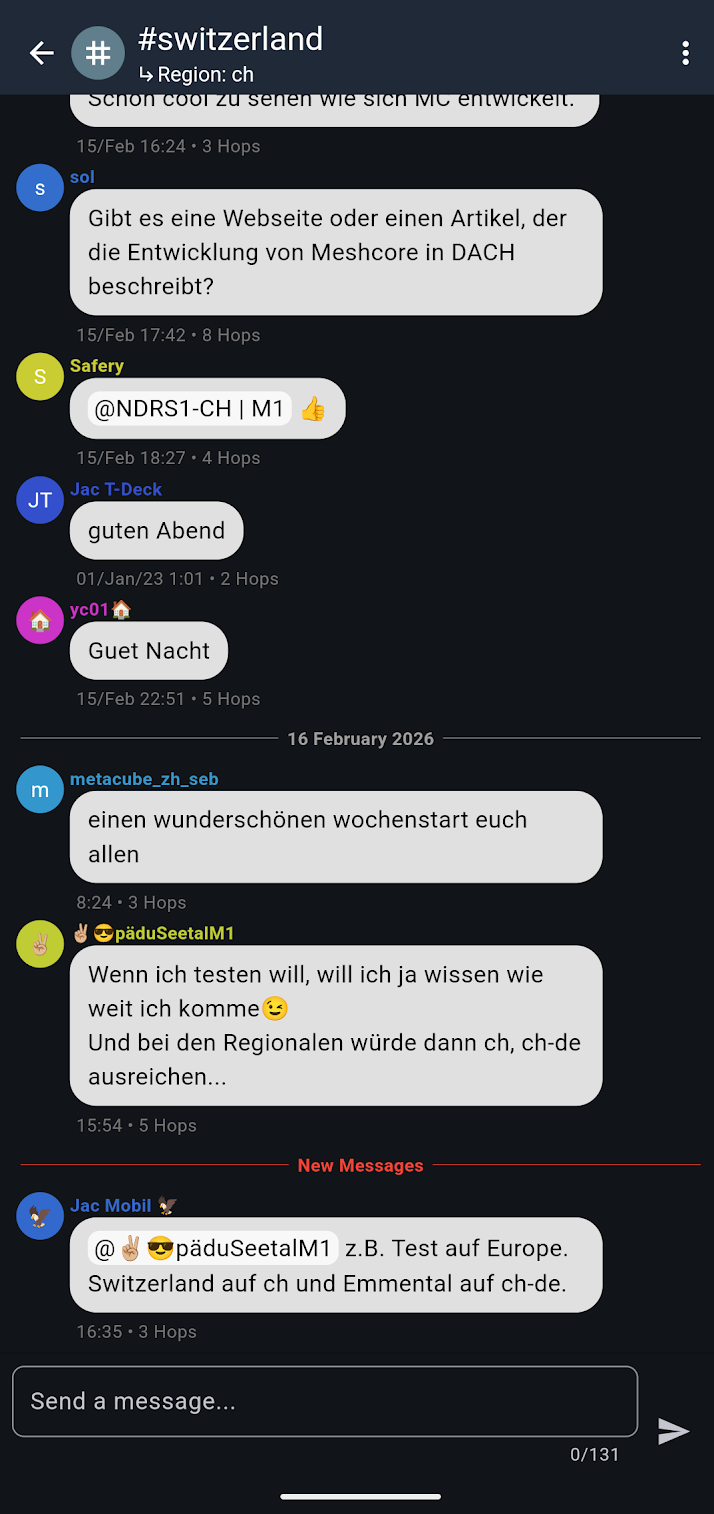

By default, everything the companion node sends now uses the region "ch". All repeaters that also have the region "ch" configured will then repeat these packets.

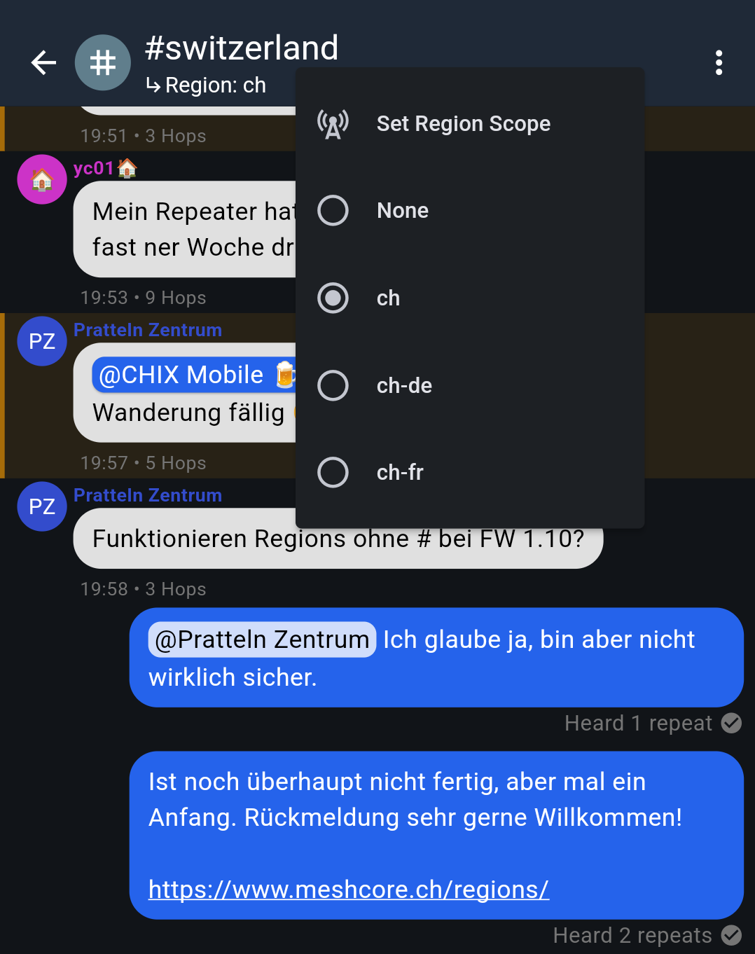

If you want to use a different region when sending messages, you don't need to change the Default Region Scope — you can set it individually for each channel:
Region Scope for Channel

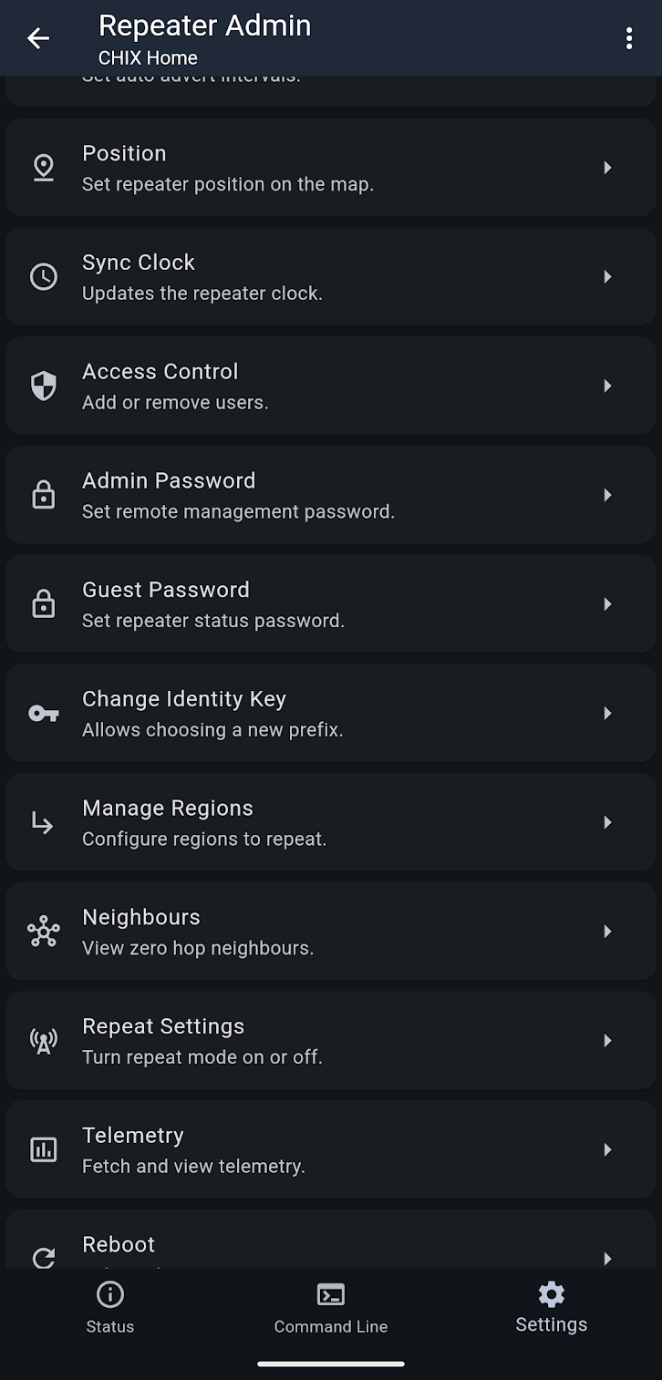

- Configuring the regions can be done conveniently via Remote Management directly from the MeshCore app. To do this, log in to the repeater and go to "Manage Regions" under "Settings".
- Then you can add the desired regions with the + button in the top right.

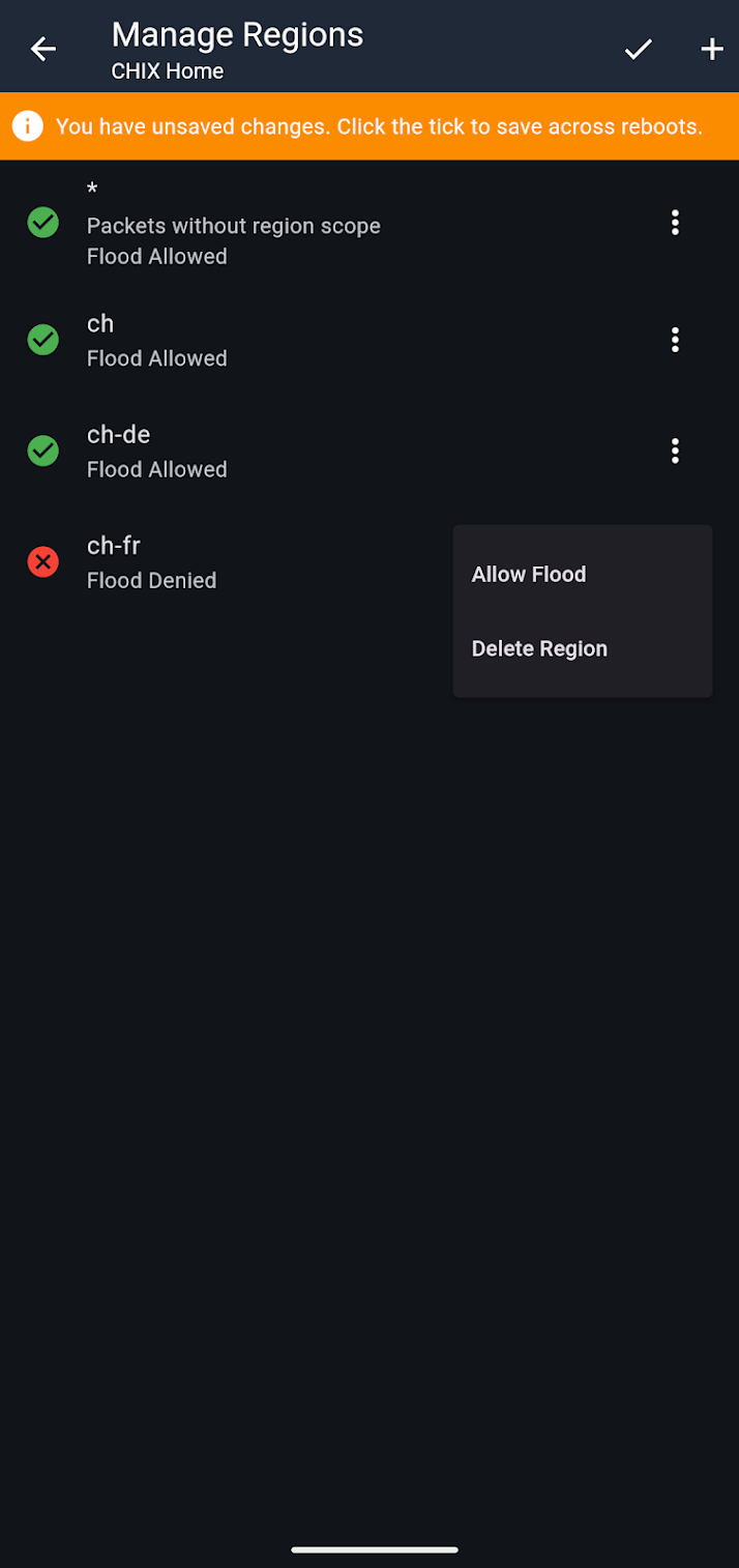

- Now you need to "Allow Flood" for each region by clicking the three dots.
- For the region *, flood routing must be disabled:

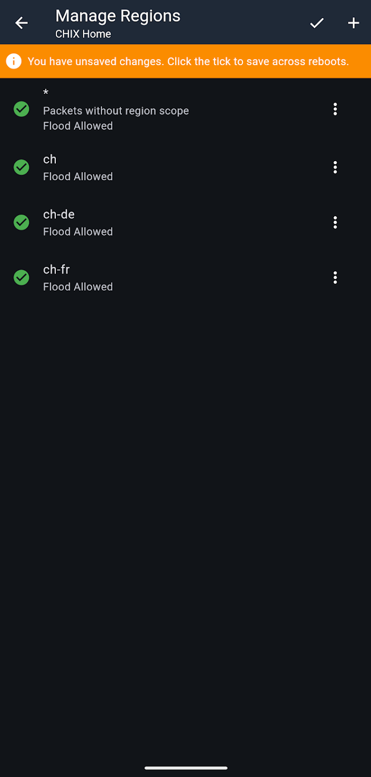

Here is a screenshot of a correctly configured repeater in Biel. Since it is located near the French-speaking region, both ch-de and ch-fr regions are configured:
